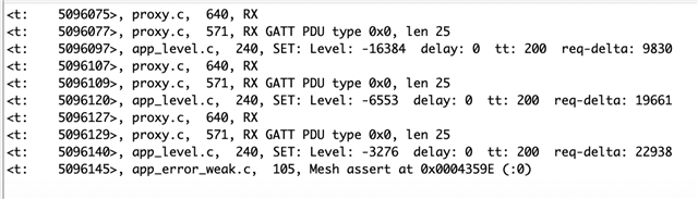

light ctl/lc example project glitch
Hi I used the light ctl/lc example project and connected to it with my iphone app which uses nordic sdk. I made a slider which sends messages quite often to the mesh device which is running the light ctl/lc example project. When I use transitions in my message and send messages quickly to the node, it makes the node crash. Why is this?
