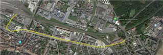

I have been implementing the GPS on my thingy:91 with the firmware v1.2.0
I'm able to do a cold start and get a FIX is if in do not move the board for around 100 seconds. And then i can trace my path.
However, if i do not stop to do the cold start, the gps will never get fix.
Why is this happening and which settings should be change to make it work ? Frequency ?
