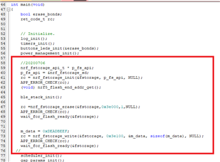

hi. I use sdk16 and ble sample like kb or mouse.  i want to save some data in ic. with flash_fstorage.
i see flash_fstorage example .it can use SOFTDEVICE_PRESENT for save.
but i use in ble sample, it can not save .it happen "app_error_fault_handler".
if i do not use SOFTDEVICE_PRESENT, flash_fstorage can save data .but if use  SOFTDEVICE_PRESENT in ble sample, it can not.
why? please.
  • i use  nRF5_SDK_16.0.0_98a08e2\examples\peripheral\flash_fstorage\pca10056\s140\arm5_no_packs is OK.
    but use nRF5_SDK_16.0.0_98a08e2\examples\ble_peripheral\ble_app_hids_mouse\pca10056\s140\arm5_no_packs
    and the same code like flash_fstorage intialize , but it happen  "app_error_fault_handler".
    only sdk_config.h maybe different.
    where is different , i do not konw..
  • nRF5_SDK_16.0.0_98a08e2_20200706.rar
    hi ,this is my projcet, include flash_fstorage and ble_app_hids_mouse.
    but only flash_fstorage with SOFTDEVICE_PRESENT  is ok, ble_app_hids_mouse is fail
    in ble_app_hids_mouse code,this is my modify like flash_fstorage.
  • The main reason that it is fails is that the ble_app_hids_mouse example uses the application scheduler to handle events from the softdevice. Since you try to write to flash right after initializing the softdevice but before initializing the scheduler, the scheduler queue will be filled before the events are processed, causing a NO_MEM error. I moved scheduler_init before fstorage calls.
    Secondly, because the softdevice events are processed in main loop, the fstorage library will not receive the events from softdevice due to the blocking wait_for_flash_ready() call, preventing the application from reaching main loop. I added a call to app_sched_execute inside wait_for_flash_ready.
    After fixing these two issues, the application got a hardfault because the fstorage_erase call erased one of the application code flash pages, but this may have been because I built the application with the debug configuration.
  • oh.. would you upload  the modify code? i can try . please .Thanks.
  • Attached main.c:

    static void fstorage_evt_handler(nrf_fstorage_evt_t * p_evt);
    NRF_FSTORAGE_DEF(nrf_fstorage_t fstorage) =
        /* Set a handler for fstorage events. */
        .evt_handler = fstorage_evt_handler,
        /* These below are the boundaries of the flash space assigned to this instance of fstorage.
         * You must set these manually, even at runtime, before nrf_fstorage_init() is called.
         * The function nrf5_flash_end_addr_get() can be used to retrieve the last address on the
         * last page of flash available to write data. */
        .start_addr = 0x4e000,
        .end_addr   = 0x4ffff,
    /* Dummy data to write to flash. */
    static uint32_t m_data          = 0xBADC0FFE;
    static uint32_t nrf5_flash_end_addr_get()
        uint32_t const bootloader_addr = BOOTLOADER_ADDRESS;
        uint32_t const page_sz         = NRF_FICR->CODEPAGESIZE;
        uint32_t const code_sz         = NRF_FICR->CODESIZE;
        return (bootloader_addr != 0xFFFFFFFF ?
                bootloader_addr : (code_sz * page_sz));
        if (p_evt->result != NRF_SUCCESS)
            NRF_LOG_INFO("--> Event received: ERROR while executing an fstorage operation.");
            return;
        switch (p_evt->id)
            case NRF_FSTORAGE_EVT_WRITE_RESULT:
                NRF_LOG_INFO("--> Event received: wrote %d bytes at address 0x%x.",
                             p_evt->len, p_evt->addr);
            } break;
            case NRF_FSTORAGE_EVT_ERASE_RESULT:
                NRF_LOG_INFO("--> Event received: erased %d page from address 0x%x.",
            } break;
            default:
    static void power_manage(void)
    #ifdef SOFTDEVICE_PRESENT
        (void) sd_app_evt_wait();
    #else
        __WFE();
    void wait_for_flash_ready(nrf_fstorage_t const * p_fstorage)
        /* While fstorage is busy, sleep and wait for an event. */
        while (nrf_fstorage_is_busy(p_fstorage))
            app_sched_execute();
            //power_manage();
    /**@brief Function for application main entry.
        bool erase_bonds;
        ret_code_t rc;
        // Initialize.
        log_init();
        timers_init();
        power_management_init();
    		//20200706
    	  nrf_fstorage_api_t * p_fs_api;
    	  p_fs_api = &nrf_fstorage_sd;
    	  rc = nrf_fstorage_init(&fstorage, p_fs_api, NULL);
        APP_ERROR_CHECK(rc);
        (void) nrf5_flash_end_addr_get();
        ble_stack_init();
        scheduler_init();
    		rc =nrf_fstorage_erase(&fstorage,0x4e000,1,NULL);
        wait_for_flash_ready(&fstorage);
        m_data = 0xDEADBEEF;
        rc = nrf_fstorage_write(&fstorage, 0x4e100, &m_data, sizeof(m_data), NULL);
