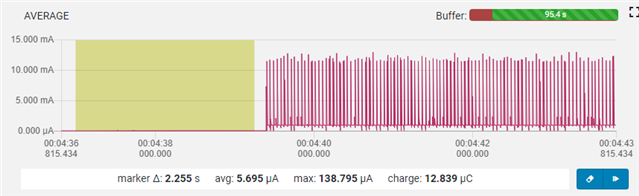

  • Thanks for the advice. I found out that sd_ble_gap_disconnect() function is used to disconnect. I executed this function on peripheral side after ble_nus_data_send returned 0x0. Whenever disconnection happens, it connects again. But, I want to keep disconnection for a while. I mean after data transmission, I don't want it to connect immediately since my overall purpose is to reduce power consumption. I made a research in forum, but I couldn't find the solution. Do you have any suggestion about that ?
  • There is no way for the peripheral side to prevent a central for making a connection to the device when it is advertising, but if you have control over both sides of the link, you can tell the central to not reconnecting to the peer it has recently been connected to. If you store the address of connected devices for a period of time that you do not want it to reconnect, you can check this list before initiating a connection. The other alternative is to stop advertising on the peripheral after the disconnect.
  • I will try your first idea. The second way works by the way. Now, peripheral device keeps disconnection for a period by using another timer.
    Lastly, I have 2 more questions:
    1. You said that the average current during sleep is about 6 uA. Sometimes the current is around 9 uA - 15 uA momentarily. What does cause that ?
    2. Is this average 6 uA current normal during sleep ? I mean that can this be more reduced ?
