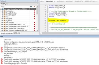

    I have created a macros in one of my header file like
    aes_Modes.h
    #define CRYPTO_CC310       0
    #define CRYPTO_MBEDTLS 1
    if we add "aes_Modes.h" header file in "sdk_config.h" and do compilation we are getting below errors continuoulsy. if we comment this file it is compiling without any errors.

    I would recommend bundling all your configuration #defines in a the sdk_config file, instead of spreading them out in different proprietary modules(unless you are using a separate config file for all your proprietary code modules, that practice is also fine). In both cases, I would recommend including your file in your main.c directly - or in your main proprietary code module - for clarity.
    From the errors generated it seems some of the defines from the sdk_config does not make it to the preprocessor.
    Is there any errors generated when you compile aes_Modes on its own?
    Could you verify for me that the SEGGER_RTT_CONFIG_MAX_NUM_UP / DOWN_BUFFERS are defined in the sdk_config?
