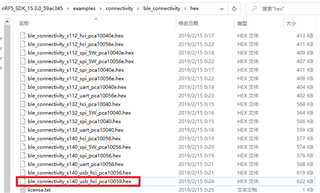

The first time,

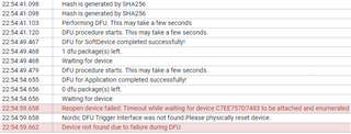

Uploaded "..\examples\connectivity\ble_connectivity\hex ble_connectivity_s140_usb_hci_pca10059.hex" by nRF Connect Programmer.
But the dongle didn't work, and nRF Connect Programmer displayed:
The second time,
I opened "..examples\connectivity\ble_connectivity\pca10059\ser_s140_usb_hci\ses ble_connectivity_s140_usb_hci_pca10059.emProject" with SEGGER Embedded Studio and built this project. Uploaded "..\examples\connectivity\ble_connectivity\pca10059\ser_s140_usb_hci\ses\Output\Release\Exe ble_connectivity_s140_usb_hci_pca10059.hex" and "..\components\softdevice\s140\hex s140_nrf52_6.1.1_softdevice.hex" by nRF Connect Programmer.
nRF Connect Programmer displayed the same errors.

  • Hi
    The reason you see that the Dongle is unable to reopen after flashing an application onto it is that it no longer is in bootloader mode. I just tested this myself with the SDK v17.0.0 connectivity example (\...\nRF5_SDK_17.0.0_9d13099\examples\connectivity\ble_connectivity\hex). After the device finished the DFU procedure and failed to reopen the device I got a pop-up saying the nRF52 Connectivity device was available in my "Bluetooth & other devices" page in Windows settings.
    For more explanation regarding the Dongle and its bootloader, please check out our Dongle Programming tutorial, which goes into detail on this.
