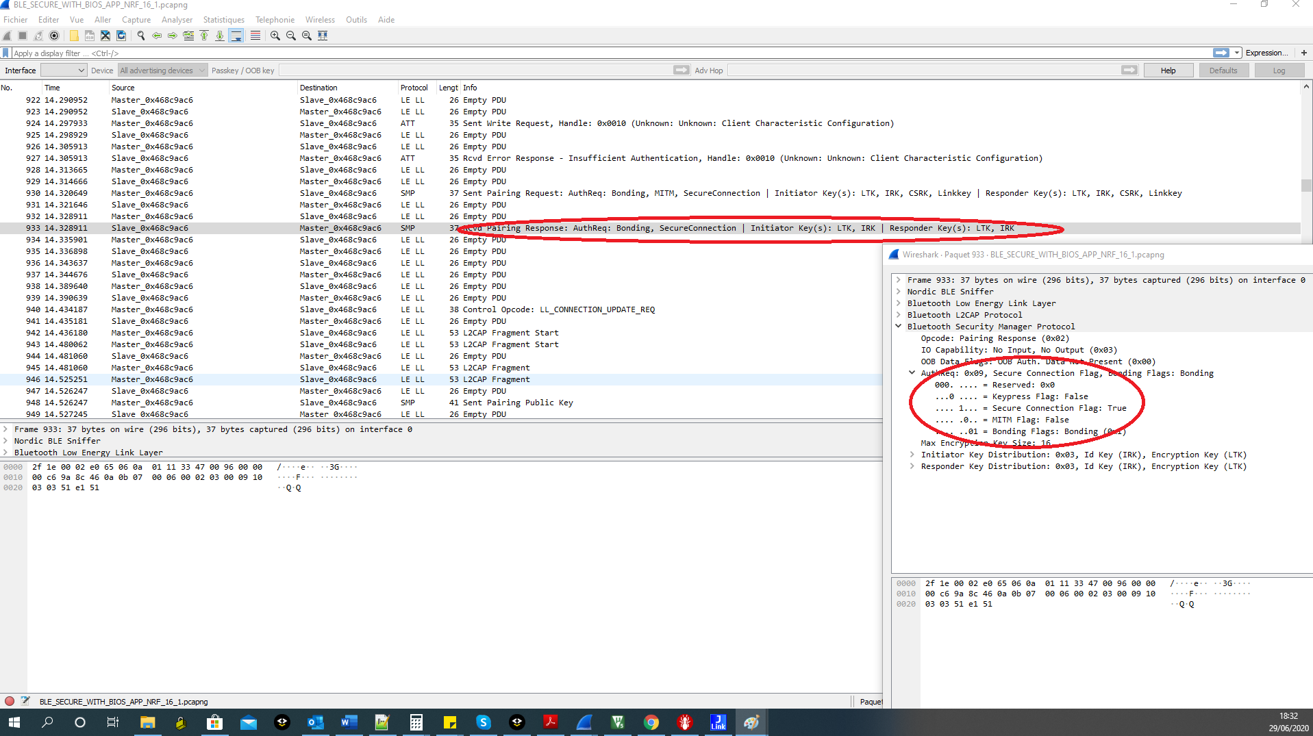

In my case, the nRF board is connected with mobile through a costume android application.
As you see in this capture, when the mobile request for pairing(when trying to enable notification), the nRF respond with IO Capability No Input, No Output and MITM protection is disabled(as expected), to ensure just work security method and than nRF exchange.

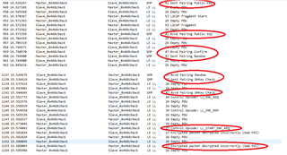

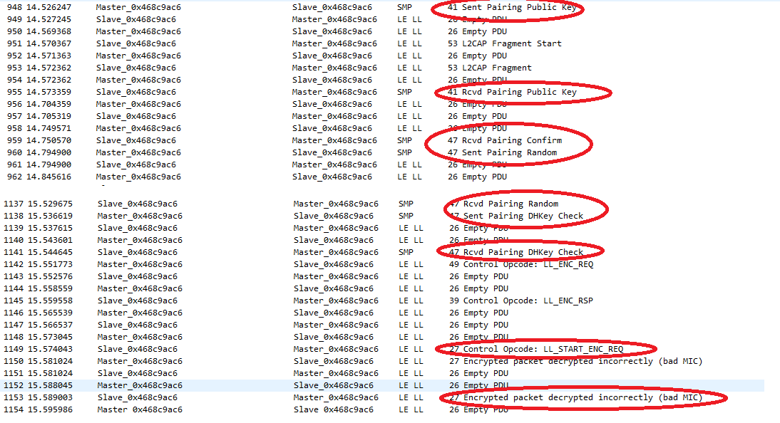

Than, nRF exchange with the mobile paring keys, check DHKey and start the encryption (see capture for more details).
After a few seconds, the mobile loss connection with nRF51.
To better understand this issue, I connected nRF51 with mobile through nRFconnect application for android, I enabled notification a first time for pairing exchanges, once the pairing exchange has proceeded, I enabled notification for the seconds to let nRF send data to the mobile, but I get the same issue.
According to the attached data, is there something missing on the mobile implementation or embedded implementation  ??
Please find attached all the sniffing traces.

    I think I solve it, in fact, previously, the write and read permission of my characteristics are set as below :
    BLE_GAP_CONN_SEC_MODE_SET_LESC_ENC_WITH_MITM(&attr_md.read_perm);/*those value should be encrypted*/
    BLE_GAP_CONN_SEC_MODE_SET_LESC_ENC_WITH_MITM(&attr_md.write_perm);
    Knowing that just work paring method is desired, the MITM should be disabled as shows the code below:
    BLE_GAP_CONN_SEC_MODE_SET_ENC_NO_MITM(&attr_md.read_perm);
    BLE_GAP_CONN_SEC_MODE_SET_ENC_NO_MITM(&attr_md.write_perm);
    Now, I'm able to enable characteristics and exchange data with nRFconnect.
