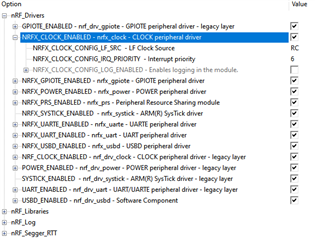

I am trying to get this example  NRF_SDK\nRF5_SDK_16.0.0_98a08e2\examples\peripheral\usbd_cdc_acm, working on a custom board,using a  BMD-340, The only changes I have made until now is the clock source, as it does not have a XTAL on board.

I got a Blinky running  in the main loop , which is working fine,  However I am getting this error on windows 10, (USB device not recognized), under device manager I get : Windows has stopped this device because it has reported problems. (Code 43).
I tried installing the USB drivers provided in the SDK but that did not help.
I got a Dev board nrf52840, and tried it on that as well and got the same results.
I was wondering if I may be missing something in my setup ?
