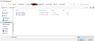

I'm now right clicking and adding an existing file, selecting the *.c and *.h files and it will import those files in, but none of their dependencies:
Now when I try to compile the project, I'll get an error about a missing file that I need to be included in order to get the project to compile:
What's the easiest way to transfer an entire library and it's dependencies?

  • That's what I did.  I started with an example project but that didn't have everything I needed in it, so I needed to take files from other example projects, which means I need to add them to this project.
    That link gave me info on how to add files (which I demonstrated above that I've actually already done).  What I need to know is how do I add the library files and all their dependencies?  That power management library has 60 dependencies and should generate a *.o file in the output folder.  The other example projects have it already setup to provide this.  Is there not a documented way to add a library to a project?  I assumed I could right click on the library folder and "add library" but there doesn't seem to be that option.
  • I think I found a solution.  Turns out I need to open the *.emProject and add the paths to the c_user_include_directories, and then make sure they're added to the library section.  That seemed to work for me.
