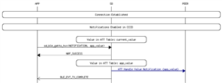

I've been working on a system to set notifications on time ready for transmission.
The client sends a WWR package to my peripheral and I want my peripheral to send a notification back in the same connection interval.
The client and peripheral both have a 7.5ms min and max connection interval.
To my knowledge a notification has to be set before the transmission moment occurs.
My approach is to have one free running timer captured as soon as I get the WWR message, I'll add that captured value with x (roughly 6ms in timer ticks) to a new compare register to create an event to set a notification ready for the next connection interval.
When the compare event strikes I do a sd_ble_gatts_hvx(....) and set my notification ready.
I've added a picture to help understand what I'm trying to achieve.
The problem I'm having is that the notification is not send as I pictured here.
Instead the notification is set at the right time but instead of being transmitted in the following connection interval, it is being transmitted in the connection interval after the intended interval.
I've tried changing the time for when the notification is set ready for transmission but this either resulted in ERROR_NO_RESOURCES or in the same behavior.

    Remember that you can queue packets at any time. If they are queued enough time before the next connection event, it will be transmitted that event. If it is queued too late, the softdevice doesn't have time to process the packet, and it will be sent the next event instead.
    Have you tried queuing the packet directly after the previous notification was sent (and you get the TX_COMPLETE event). In that case it should be sent the very next connection event.
    An alternative is to use something called radio notifications, whic is a module that makes it possible to get events a given amount of time before the next connection event.
    Please check out this guide for how to setup and use radio notifications:
    https://devzone.nordicsemi.com/nordic/short-range-guides/b/software-development-kit/posts/radio-notification
    What you are probably seeing is that you start an app_timer right after a connection event. This timer will not be started until the softdevice is done, so perhaps you queue it too late? How much data do you send before you start the timer? If you have enabled data length extension and event length this may actually take a lot of time.
    I suggest either using the TX_COMPLETE event (called BLE_GATTS_EVT_HVN_TX_COMPLETE. Add this to your ble_evt_handler) to queue the next notification, or look into using the radio notifications, and experiment with different timings (NRF_RADIO_NOTIFICATION_DISTANCE_800US). Depending on how much data you queue, you need a different amount of time.
