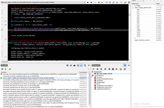

Getting a MESH ASSERT on 'subscription delete all'
as describe in the title, we are getting a mesh assert when trying to remove all suscibtions from a model.
it is kind of hard to reproduce because this command is not implemented in NrfMesh app, so we are implementing it in our App.
The assert appear when calling this command for the first time after a full erase of the dk board and the first provisionning.
regarding the SDK 4.1 for Nrf52840, the assert is caused by this:
device_state_manager.c : 2036 - 2048
uint32_t dsm_address_subscription_remove(dsm_handle_t address_handle)
    if (address_handle_valid(address_handle))
        nrf_mesh_address_t addr;
        uint32_t status = dsm_address_get(address_handle, &addr);
        if (status == NRF_SUCCESS)
            if (addr.type == NRF_MESH_ADDRESS_TYPE_GROUP)
                if (m_addresses[address_handle].subscription_count == 0)
                    return NRF_ERROR_NOT_FOUND;  // <-- this
called from:
config_server.c : 496
        NRF_MESH_ASSERT(dsm_address_subscription_remove(subscribed_addresses[i]) == NRF_SUCCESS);
after restarting the node, this command works fine.
can you please take a look and tell me where is the probleme?
best regards
B
