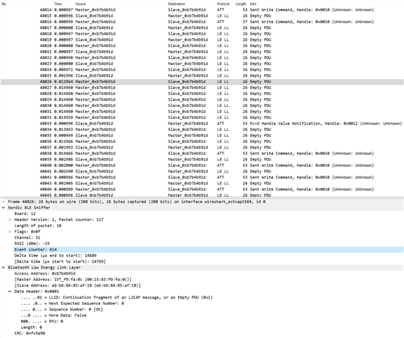

During the time when the flash erase is happening, we've captured instances with and without the channel map update request.  Without the request, the device also stops responding, but eventually recovers:

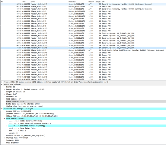

If the slave receives a LL_CHANNEL_MAP_REQ message during the erase, it misses the instant and disconnects:

    Is it expected that the soft device will miss some connection intervals in order to perform the erase?  It seems like missing the connection intervals only becomes a problem when the channel map update is received and the slave needs to respond and update its channel map within 6 connection intervals (90 ms), when the instant occurs.
    I wonder if the situation could be improved by increasing the connection interval slightly so that the erase (plus some margin) will finish in under 6 connection intervals.  Thoughts?
  • I think the central decides what instance the LL_CHANNEL_MAP_REQ will apply from. If it says 6 connection intervals, then in my view, this is the "bad behavior", since this is far shorter than the connection timeout itself (but not illegal as far as I know).
    I reviewed a handful of BLE sniffer trace logs that involved masters of Android and iOS phones as well as Windows desktops, and almost all used instants that were 6-8 connection events later. It seems this is typical behavior.
    The central will also consider the link lost, because this packet is not replied to.
    Does this mean that although BLE is usually robust with retries, the channel map update or connection param update instant must have a round trip packet exchange in the specific connection event? If the slave fails to receive the packet or the master fails to receive the response, a connection will always disconnect? It seems like in general, there would be more frequent disconnections occurring especially if these update procedures happen when devices are at range or in a negative RF environment where packet retries would occur regularly.
     Yes. According to the BLE specification, the central decides on connection parameters. Since this "request" is effective from a specific connection event, if the peripheral fails to reply/ACK this packet before this event, the devices shall disconnect.
