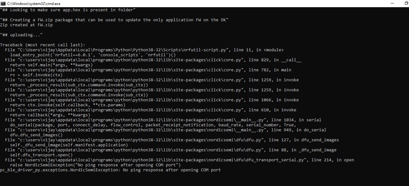

  • Hi Edvin,
    For testing I am using below development board which has the UART pins P0.08 and P0.06
    https://learn.adafruit.com/bluefruit-nrf52-feather-learning-guide?view=all
    So you know  I want to test UART bootloder,
    I have compiled below example
    nRF5_SDK_15.3.0_59ac345\examples\dfu\secure_bootloader\pca10040_uart
    and take its hex file as bootloader.hex.
    Currently, I have merged bootloader.hex, softdevice, settings, and blinky_app.hex
    and just uploaded firmware using Segger Jlink EDU.
    It work fine and adverising as Nordic_blinky.
    I have generated zip file with softdevice or without soft device. then I have tried below command but thats not works.
    nrfutil dfu serial -pkg FW.zip -p COM3 -b 115200
    Can you guide me?
    Thanks.

  • Ok, so let us focus on the noSD .bat script. To simplify, you are using the command:
    nrfutil pkg generate --application app.hex --application-version 1 --application-version-string "1.0.0" --hw-version 52 --sd-req 0xB7 --key-file private.pem FW.zip
    Right?
    Try removing the --application-version-string argument.
    And I will ask one more time:
    Edvin said:
    what do you mean by "that not works"? What does it say when it doesn't work?
     Does nrfutil say anything? Or does it say: "sorry. It didn't work"?. Perhaps you can share a screenshot.
  • Hi Edvin,
    See the screenshot
    using above command , not be able to upload firmware via uart.
  • Ok, so your UART is not working. It is not responding. Your UART pins are probably not routed to your computer. Does your module (BMD301) have an on board debugger?
    Is the BMD301 equipped with an onboard debugger?
    I think you need to check with the producers of the BMD301 if and how the UART pins are connected to the BMD's programmer (if it has a programmer). Or maybe it says in the datasheet.
    BR,
    Edvin

  • VIJAY said:
    -  When I have uploaded BLE bootloader, then I have merged with below example
    nRF5_SDK_15.3.0_59ac345\examples\ble_peripheral\ble_app_buttonless_dfu
     What does this mean? What did you merge the ble_app_buttonless_dfu example with?
    Have you tried to debug in the bootloader project? Set a breakpoint and see if it is hit or not.
    You didn't merge the bootloader project with the buttonless_dfu example? The bootloader is supposed to be a standalone project and hex file.
    The way the bootloader works is that if you program either the softdevice or the MBR (the MBR is included in the softdevice) whenever you reset the nRF the MBR will check if there is a bootloader present or not. If there is a bootloader, it will run the bootloader. If the bootloader doesn't see any sign on staying in DFU mode (button press or register set by the buttonless_dfu_service) it will continue by starting the application.
    What do you intend to do with the DFUMaster_UART project that you attached? That is not related to the bootloader itself. This is a demo replacement project for nrfutil. The bootloader is located in SDK\examples\dfu\secure_bootloader.
    VIJAY said:
    I think, in this code, something is added which helps to enable bootloader mode when I pass it zip file via nrf connect application in DFU service.
     Is that your question now? How to put the device in DFU mode? This has to be done either by the application or by e.g. pressing a button while resetting the device. If your application is running, then nrfutil will not be able to communicate with the bootloader.
    This is a long shot, but I will try.
    If you want to trigger DFU mode via UART, you have to do this from your application. If you look in the bootloader project, study the function:
    nrf_bootloader_init() -> dfu_enter_check():
    if (NRF_BL_DFU_ENTER_METHOD_GPREGRET &&
           (nrf_power_gpregret_get() & BOOTLOADER_DFU_START))
            NRF_LOG_DEBUG("DFU mode requested via GPREGRET.");
            return true;
    If the GPREGRET register is set to 0xB1, it will enter DFU mode, so if you write this to your application before you reset, it will enter dfu mode. Perhaps you can use some special UART command to trigger this. E.g. if you receive "dfu mode enter" over the UART, then you have a handler that will set this register and then reset:
    static void enter_dfu_mode(void)
        uint8_t gpregret_value = nrf_power_gpregret_get();
        gpregret_value |= 0xB1; // Add (or) 0xB1 to whatever the value was before.
        nrf_power_gpregret_set(gpregret_value);
        while ((nrf_power_gpregret_get() & 0xB1) != 0xB1)
            // Wait for the register to be properly written before we continue.
        NVIC_SystemReset(); // Reset the nRF. With the given gpregret the bootloader will enter DFU mode.
    If you call this from somewhere in your application, the nRF will enter DFU mode. Quite similar (but not exactly) to how the ble_app_buttonless_dfu example does it.
    BR,
    Edvin
