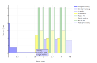

By way of confirmation I used the Online Power profiler to get an idea of what to expect and it suggests a standby current of 200uA might be expected
This seems really high to me?
Also if I select the option to turn the DCDC on the standby current increases - also very unexpected?
Can anyone explain why the current profiler indicates such a high standby current? I would have expected it to be in the single digit microamps!!

    This standby current you're seeing in the online power profiler is the standby current before the radio turns on, where the HFCLK is running (consuming ~200µA). The sleep current should not be as much as 100µA either like what you're seeing on your device. I assume you have a peripheral still running that is drawing this extra current, as an nRF52832 in sleep mode running the RTC in sleep mode shouldn't consume more than ~2.6µA. Please see this table for more information on the sleep mode currents (yes this is from the nRF52833 PS, as we haven't updated the nRF52832 PS to include these current consumption scenarios, but they are very similar in terms of current consumption).

    I think you're misunderstanding the Online Power Profiler, as the standby you're pointing to is what is between the wake-up/HFCLK start until the radio starts up, which is why it is stated as 0.2mA in the OPP. Can you confirm whether this is the timeslot you're measuring the current consumption in as well (see picture below), or are you measuring between the advertising events themselves?
    If you're seeing 100µA in the idle between ramp-up and radio, there must be something wrong with the way you're measuring the current consumption, as the HFCLK is definitely running in this timeslot. If you're seeing 100µA between advertising events, that likely means that one of the peripherals you're using is not uninitialized properly.

    Your other comment about me misunderstanding the OPP was correct, I had assumed 'standby' meant between advertising, I had not fully taken notice of the ~1000us duration!!
