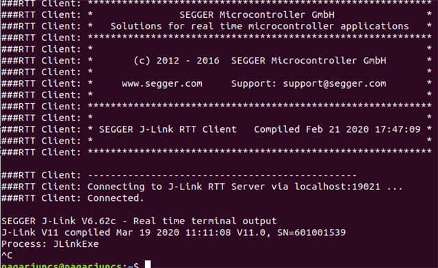

  • I realized that soon and took care of it instantly and corrected it in sdk_config. But, after i corrected I get no debug messages after flash.
     Did you build the project without any errors and was is flashed successfully? What do you observe on the board, is it advertising?
  • Okay, starting from building from building bootloader, i built the secure_bootloader project with no errors (after adding custom_board.h and enabling buttonless features in sdk_config) and flashed the soft device and bootloader succesfully. Now, the device advertises successfully in DFU mode, there is no problem there.
    But, after I flash my application (built with no errors)even though flashing is succesfull the device shutsdown without advertising. I checked if memory adjustements have to be so,i attahced debugger, but I see no debug results.
