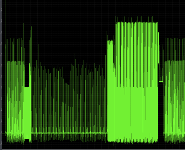

  • The advertising interval is not what I use.  I utilize a ~ 155ms interval and I'm seeing ~500ms.
    Note that I verified I'm calling the same function nrf_pwr_mgmt_run(); in a tight loop as does the button-less DFU example.
    I have a 1 second timer interrupt where I wake up and evaluate the environment and act as needed, then I go to sleep ( nrf_pwr_mgmt_run() ) until the next 1 second interrupt.
    There is no other activity going on in the application.
    looking at the current flow below, starting from the left - going in large blocks
    1) power up
    2) Initial advertising (155ms)
    3) First Solid block - is nrfConnect connecting to my device and my staring the DFU
    4) nrfConnect disconnects and the device then advertises for ~1-2 minutes @ 500ms intervals
    5) the next solid block is nrfConnect re-establishing connection
    6) the large block (about 1/4 the entire .jpg is the DFU file transfer
    7) followed by disconnect and restart of the device
    8) at the far right of the photo is the device starting up again with 155 ms advertisements.
    Hope this helps
    Peter
  • Hi Peter,
    I have just tested here with the nRF Connect and nRF52832 but I don't see the same issue. The buttonless application switched to the bootloader in about 2-3 seconds and then the bootloader get connected right after that.
    Please try to test doing DFU again using nRF Connect app on the phone (Android/iOS) to check if it works.
    Also please try testing using stock buttonless (and stock bootloader) example.
    In stead of checking the current consumption, you can also check which firmware is running by using a sniffer or using a phone to scan for BLE advertising packet.
