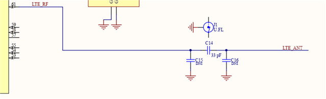

I just purchased a row of new nrf9160 SiPs for our IoT products. We are testing with new made cuicuits.
We use the same circuit schematic that worked with previous nrf9160s but small layout size.

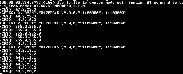

We tried to connect to NB-IoT network, but it takes long time without any successful connections.
I enable AT command "AT+CEREG=5" to receive any reject causes but I could not figure out the clear cause.
For SIM card and antenna, we tested the antenna and SIM with our previous circuit and it connected.
