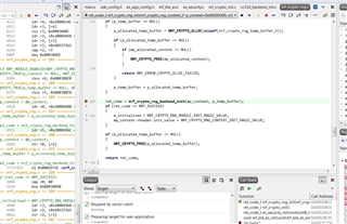

The default project doesn't include PCA10100.
I am trying to create one, but it always stuck in the function nrf_crypto_rng_backend_init file nrf_crypto_rng.c.
The project is working fine with PCA10056 and PCA10040.
Would you please help me to fix this.

    This error is expected, as the CryptoCell peripheral is not present on the nRF52833, so there's no point in trying to use it.
    You will have to use a SW crypto backend, but you don't need to make any significant changes, as the nrf_crypto library provides a unified API. The only thing you need to do is to disable the CC310 backend in sdk_config.h by setting NRF_CRYPTO_BACKEND_CC310_ENABLED to 0, and enable the Oberon backend by setting NRF_CRYPTO_BACKEND_OBERON_ENABLED to 1, as well as setting the NRF_CRYPTO_BACKEND_NRF_HW_RNG_ENABLED to 1. You can compare with the sdk_config.h of the pca10040 project to see how this should be done, and they should be identical with regard to crypto configuration.
