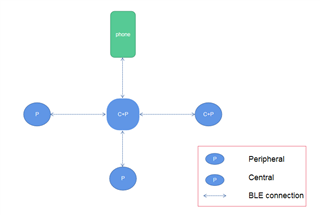

In our product development, we finally found that our products need to work in long range mode to improve the communication range, and keep the connection with mobile phone at the same time. so my first question is, is it possible to make the BLE 1M conexist with long range mode?  Is there any example and related document for me?
We connect our products with each other by a start network base on BLE connection:

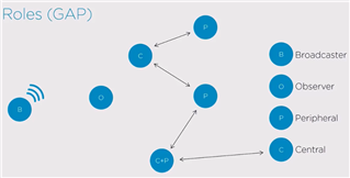

but we have more intresting in the MESH like network which was showed in webinar video " introduction-to-blue-low-6-1-video':  , and is there any example and document for reference?

  • Hi
    The S132 and S140 SoftDevices allow you to run up to 20 connections simultaneously, and you can use different PHY's on the different links if you want.
    In other words it is possible to have one connection running in 1M mode, and another connection running in long range mode.
    We don't have any examples showing how to do this type of connected Bluetooth mesh unfortunately.
    We have an implementation following the Bluetooth mesh standard, but this is based on advertise packets and not Bluetooth connections. The advantage of this is that it is easy to support a large number of nodes in the network, but you get higher current consumption and lower data rate than you would with a connected mesh implementation.

  • Thanks, Torbjørn
    As your mention: Another option in BT mesh is to set up a GATT proxy node, which is simply connecting to one of the mesh relay nodes over a normal Bluetooth connection (GATT connection). This can yield even lower average currents than the LPN
    I draw the below illustration, the LPN node communicate with the Mesh relay node via GATT would be consume less power, Is it right?
    By the way, is it possible to let the Mesh relay connect with multiple LPNs, like the left Mesh relay node in the illustration?
    Thank you!
    The term "Low Power Node" (LPN) is for nodes that communicate using the normal ADV bearer for communication, but has a "Friend node" in the network that will store all messages addressed for the node. The LPN can then wake at certain intervals, and poll the Friend node for new messages.
    If you use the GATT bearer, it will not be a "Low Power Node" in Bluetooth mesh terminology, but it will look similar to your illustration, yes. Except what you marked as "LPN" will be GATT client nodes, and what you marked as "Mesh relay" will be nodes with the GATT proxy feature enabled ("GATT proxy nodes").
    GATT proxy nodes can connect to multiple GATT client nodes yes.
