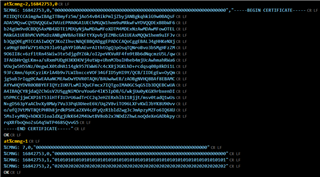

I have two nRF9160DKs and I noticed that the SHA-256 digest of the credentials looks very strange
Questions:
1, Why are the digest so repeating? I have installed the JSON credentials got from nRF Cloud without error.
The software is firmware/images_full/nrf9160dk_at_client_2020-04-29_bc7ade8b.hex and mfwnrf916012.zip.
2, During my tests I deleted the first credential with sec_tag 0 from device with image 1.
The device seen on image 2 has that credential. How can I set back that credential?
3, On image 2: what is that credential with sec_tag 0 anyway?
It has type 6 but according to nrf91_at_commandsv1.2.pdf "4.28 Credential storage management %CMNG"
there are types only 0-5.
