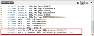

I have included UART functionality in light switch server code to interface a sensor.Now upon receiving 5 bytes from UART I want to publish that data over mesh to client node.
But as soon as I send 5 bytes from UART I receive below error in attachment.Please help.
Note : Where as if I call app_onoff_status_publish2(&m_onoff_server_0)  from button_event_handler it does work.But I don't want dependency of button.

    Is this a custom function (if so what does it look like), or is the "2" in the function name a spelling error? Are you using the unchanged app_onoff_status_publish() from examples/common/src/app_onoff.c, or have you changed it? (If changed, what does it look like?)
    I suspect this may have to do with what interrupt priority level the code is running from, when you call app_onoff_status_publish(). From what interrupt priority level does the uart event handler run? See more here: Setting interrupt priority levels.
