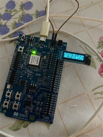

Hi Nordic folks!
I'm in troubles with a Nordic nRF52 DK and a SSD1306 Display. I'm not able to print anything in the oled screen, I don't really sure if it the problem it's in the SSD1306 code functions, or it's in the TWI library. I'm using the SDK 15.2.0 TWI_SCANNER example adding this code in the main file.
I was trying to debugging but the code and it crash in the twi_tx() function.
Could someone test it??
I leave you here the code and a photo from my trouble.

    Did you check the TWI bus with a logic analyzer to see if all commands are sent correctly to the display?
    Note that the nrf_drv_twi_tx/rx API has only 8bit length fields due to a limitation in supported EasyDMA size in nRF52832 chips. If you need to write more data than 255 bytes in one transfer you need to use the legacy TWI with nrfx_twi.c driver. Alternatively, you can split the data into multiple transfers if the slave supports this.
    Jørgen
  • Hi Jorgen,
    I'm going to try with the Logic Analyzer the response with an Arduino device, and with the libraries too, and I'll check the differents between frames.
    I'll notice you.
    Although, I've started to develop my own TWI function to test if the problems are in the SDK libs.
    I leave you here the code if you want or can try it with a logic analyzer.

  • Hi folks!!
    Finally, I achieve that the SSD1206 Oled works!! The problem was, as you suggest, in the buffer limitation.
    As the SSD1306 is 128x32, the number of bytes that you have to send is about 514 bytes. So, you have to distribute it in 3 TWI transmissions. And that's all it finally works.
    I leave you here a video with the results.
    And also the code, for if it could help someone else.

        NRF_GPIO->OUTSET |= (1<<2);
        NRF_GPIO->PIN_CNF[3] |= (GPIO_PIN_CNF_DIR_Output << GPIO_PIN_CNF_DIR_Pos);
        NRF_GPIO->OUTSET |= (1<<3);
        NRF_GPIO->PIN_CNF[26] |= (GPIO_PIN_CNF_PULL_Pullup << GPIO_PIN_CNF_PULL_Pos ) | ( GPIO_PIN_CNF_DIR_Input << GPIO_PIN_CNF_DIR_Pos ) | (GPIO_PIN_CNF_DRIVE_S0D1 << GPIO_PIN_CNF_DRIVE_Pos); // 3 PULL_UP | 0 DIR | 8 Drive sense
        NRF_GPIO->PIN_CNF[27] |= (GPIO_PIN_CNF_PULL_Pullup << GPIO_PIN_CNF_PULL_Pos ) | ( GPIO_PIN_CNF_DIR_Input << GPIO_PIN_CNF_DIR_Pos ) | (GPIO_PIN_CNF_DRIVE_S0D1 << GPIO_PIN_CNF_DRIVE_Pos); // 3 PULL_UP | 0 DIR | 1 INPUT Buffer | 8 Drive sense
        NRF_TWIM0->ENABLE = TWIM_ENABLE_ENABLE_Disabled << TWIM_ENABLE_ENABLE_Pos; //Turn off TWIM0
        NRF_TWIM0->PSEL.SCL = 0x1A; //SCL Pin
        NRF_TWIM0->PSEL.SDA = 0x1B; //SDA Pin
        NRF_TWIM0->ADDRESS = address; //Slave device address
        NRF_TWIM0->FREQUENCY = 0x01980000; //100kHz TWI frecuency
        NRF_TWIM0->ENABLE = TWIM_ENABLE_ENABLE_Enabled << TWIM_ENABLE_ENABLE_Pos;
        NRF_GPIO->PIN_CNF[18] |= (GPIO_PIN_CNF_DIR_Output << GPIO_PIN_CNF_DIR_Pos);
        NRF_GPIO->OUTCLR |= (1<<18);
        NRF_LOG_INFO("TWI scanner started.");
        NRF_LOG_FLUSH();
        twi_owner_init(0x3C);
        NRF_TWIM0->SHORTS = TWIM_SHORTS_LASTTX_STOP_Enabled <<TWIM_SHORTS_LASTTX_STOP_Pos;
        NRF_LOG_INFO("TWI init\n");
        NRF_LOG_FLUSH();
        uint8_t tx_buf[]={0x00,0xAE,0xD5,0x80,0xA8};
        NRF_TWIM0->TXD.MAXCNT = sizeof(tx_buf);
        NRF_TWIM0->TXD.PTR = (uint32_t)&tx_buf[0];
        NRF_TWIM0->EVENTS_STOPPED = 0;
        NRF_TWIM0->TASKS_STARTTX = 1;
        while(NRF_TWIM0->EVENTS_TXSTARTED == 0){};
        while(NRF_TWIM0->EVENTS_LASTTX == 0){};
        nrf_delay_us(100);
        while (NRF_TWIM0->EVENTS_STOPPED == 0){};
        uint8_t tx_buf1[]={0x00,0x1F};
        NRF_TWIM0->TXD.MAXCNT = sizeof(tx_buf1);
        NRF_TWIM0->TXD.PTR = (uint32_t)&tx_buf1[0];
        nrf_delay_us(100);
        uint8_t tx_buf2[]={0x00,0xD3,0x00,0x40,0x8D};
        NRF_TWIM0->TXD.MAXCNT = sizeof(tx_buf2);
        NRF_TWIM0->TXD.PTR = (uint32_t)&tx_buf2[0];
        nrf_delay_us(100);
        uint8_t tx_buf3[]={0x00,0x14};
        NRF_TWIM0->TXD.MAXCNT = sizeof(tx_buf3);
        NRF_TWIM0->TXD.PTR = (uint32_t)&tx_buf3[0];
        nrf_delay_us(100);
        uint8_t tx_buf4[]={0x00,0x20,0x00,0xA1,0xC8};
        NRF_TWIM0->TXD.MAXCNT = sizeof(tx_buf4);
        NRF_TWIM0->TXD.PTR = (uint32_t)&tx_buf4[0];
        nrf_delay_us(100);
        uint8_t tx_buf5[]={0x00,0xDA,0x02,0x81,0x8F};
        NRF_TWIM0->TXD.MAXCNT = sizeof(tx_buf5);
        NRF_TWIM0->TXD.PTR = (uint32_t)&tx_buf5[0];
        nrf_delay_us(100);
        uint8_t tx_buf6[]={0x00,0xD9};
        NRF_TWIM0->TXD.MAXCNT = sizeof(tx_buf6);
        NRF_TWIM0->TXD.PTR = (uint32_t)&tx_buf6[0];
        nrf_delay_us(100);
        uint8_t tx_buf7[]={0x00,0xF1};
        NRF_TWIM0->TXD.MAXCNT = sizeof(tx_buf7);
        NRF_TWIM0->TXD.PTR = (uint32_t)&tx_buf7[0];
        nrf_delay_us(100);
        uint8_t tx_buf8[]={0x00,0xD8,0x40,0xA4,0xA6,0x2E,0xAF};
        NRF_TWIM0->TXD.MAXCNT = sizeof(tx_buf8);
        NRF_TWIM0->TXD.PTR = (uint32_t)&tx_buf8[0];
        nrf_delay_us(100);
        nrf_delay_ms(2000);
        ssd1306_cleardisplay();
        for(int i = 0; i < 127; i++) ssd1306_draw_pixel(i,25,WHITE);
            for(int i = 0; i < 127; i++) ssd1306_draw_pixel(i,17,WHITE);
                for(int i = 0; i < 127; i++) ssd1306_draw_pixel(i,10,WHITE);
        uint8_t tx_buf9[]={0x00,0x22,0x00,0xFF,0x21,0x00};
        NRF_TWIM0->TXD.MAXCNT = sizeof(tx_buf9);
        NRF_TWIM0->TXD.PTR = (uint32_t)&tx_buf9[0];
        nrf_delay_us(100);
        uint8_t tx_buf10[]={0x00,0x7F};
        NRF_TWIM0->TXD.MAXCNT = sizeof(tx_buf10);
        NRF_TWIM0->TXD.PTR = (uint32_t)&tx_buf10[0];
        nrf_delay_us(100);
        uint8_t tx_buf11[255];
        tx_buf11[0]=0x40;
        for(int i = 1; i < 255; i++){
          tx_buf11[i] = buffer[i];
        NRF_TWIM0->TXD.MAXCNT = sizeof(tx_buf11);
        NRF_TWIM0->TXD.PTR = (uint32_t)&tx_buf11[0];
        nrf_delay_ms(100);
        uint8_t tx_buf12[255];
        tx_buf12[0]=0x40;
          tx_buf12[i] = buffer[i+255];
        NRF_TWIM0->TXD.MAXCNT = sizeof(tx_buf12);
        NRF_TWIM0->TXD.PTR = (uint32_t)&tx_buf12[0];
        nrf_delay_ms(100);
        uint8_t tx_buf13[]={0x40,0x00,0x00};
        NRF_TWIM0->TXD.MAXCNT = sizeof(tx_buf13);
        NRF_TWIM0->TXD.PTR = (uint32_t)&tx_buf13[0];
        NRF_LOG_INFO("%d\n",sizeof(tx_buf13));
        NRF_LOG_FLUSH();
        nrf_delay_ms(100);
        while(1){
         __WFE();
  • Hi folks!!
        nrf_delay_us(100);
        nrf_delay_us(100);
        nrf_delay_us(100);
        nrf_delay_us(100);
        nrf_delay_us(100);
        nrf_delay_ms(2000);
        nrf_delay_us(100);
        nrf_delay_us(100);
        tx_buf11[0]=0x40;
        nrf_delay_ms(100);
        tx_buf12[0]=0x40;
        nrf_delay_ms(100);
        NRF_LOG_FLUSH();
        nrf_delay_ms(100);
        while(1){
         __WFE();
