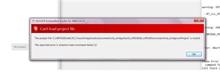

1. By the toolchain manager, the sdk connect and zipped toolchain were downloaded.
    I used the downloaded SES to compile examples. For others, they can compile successfully.

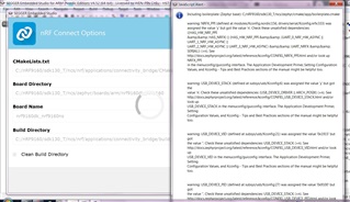

    For \nrf\applications\connectivity_bridge, it got error when I opened nRF Connect options.
    Please see attached PIC1 and PIC2.

    1. The connectivity bridge is made for the nRF52840 on the Thingy:91, so try building for the board "thingy91_nrf52840".
