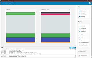

When I program up a DK with the combined hex files, it goes into application mode as supposed but it fails to recognize the bootloader and settings Thus I can't go into buttonless DFU. nrfConnect Programmer shows this:

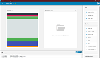

The merged hex files are on the right and it shows that the bootloader and settings are viewed as application data on the DK. For comparison here's the working ZIP:
It has recognized the bootloader and settings.
nrfConnect Programmer shows that the bootloader, settings and softdevice are set to the same address in memory however, the size of the bootloader and application is different obviously due to the changes I've made. I've tried reverting my changes to the bootloader but no luck.

    First of all, the color coding in nRF Connect for Desktop doesn't matter in this case. It is just an educated guess, and based on how the flashed .hex file looks. Whether it is green, or it has the black and red sections doesn't say anything about the content.
    So the short answer is that I don't know whats going on without knowing anything about the changes you have done to the bootloader. If you have flashed a softdevice and a bootloader, then the bootloader will always execute before the application. You say that the issue is that you can't go back to DFU mode? If so, I would suggest that you try to start with an unmodified bootloader just to see how things work. You can follow this guide.
