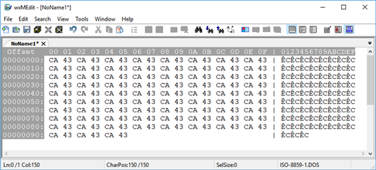

Issue 1) I am storing the terminal window into a log file and using RTT logging to channel 0; they are giving different results
The intent is to store the ADC data quickly to the desktop using binary. The logging to the terminal window is outputting two of the four bytes with an unrelated third byte in between them, irrespective if I use a 2 or a 4 for the number of bytes to output in the write statement. There are about 169 of the 256 samples output to the SES terminal logging window.
Issue 2) The channel 0 logging window is outputting a lot of undesired text (I would like to not have in the file) and then outputs 2 of the 4 bytes only for about 65 of the 256 samples.

> The four bytes in order should be {0xca, 0x43, 0x00, 0x00} for example. There are too few samples, the outputted  samples don't start with the first one (established using breakpoints), the 0x00 samples are missing.
Following is a dump from the file produced setting Project Options->Debugger->Debug Terminal Log Window: notice that again, the 0x00's are missing, and that additional bytes have been added (with values between 0x82 and 0x8A), and that not all the samples have been ouput but many more samples than were output using the RTT Viewer Terminal Logging. I have read Segger's J-Link manual more times than I know, and it's documentation is at best sketchy. I also can't find anything searching DevZone that seems to address this issue.

    SEGGER_RTT_Write() expects a char array. The 0x00 char is the \0 string termination character. I see that the 0x00 bytes are present in the RTT upload buffer during debugging, but I believe that J-Link RTT Viewer/Logger will interpret these as string end and filter it out of the log. The additional/wrong data you see in the log seems to come from the encoding format of the file reader you are using. ASCII/UTF-8 only defines symbols of characters from 0 to 127 (0x00 to 0x7F). Since 0xCA is above this, it may be undefined/replaced in the hex viewer if it expected a different format. I tested the logs from J-Link RTT Viewer in a hex-editor that supports ISO-8859 encoding (wxMEdit), and it seems to show the symbols correctly in hex-view.
    Note that RTT is typically used for text-logging. It may not work very well with logging binary data. Maybe you can log the data as ASCII text strings?
    This is something you need to check with Segger, as they are the ones creating the RTT client software. They have their own forum here.
