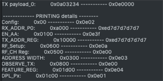

So the interrupt on the nRF2401+ seems to be working inconsistently. I get interrupts sometimes and sometimes I don't.
For a context: I'm transmitting a sensor data only when the user types in something in the command line. And sometimes I have also seen IRQ triggering even though none of the interrupt bits are set `(RX_DR, TX_DS, MAX_RT)`.
Following is what I'm printing after sending a payload. You can see dynamic payload length, PWR_UP are enabled and PRIM_RX is disabled (TXing), but interrupt never gets fired.

  • I think it is easier if you can test it at the moment, then we can first identify it is the cause.
    Kenneth
  • adding 10us delay didn't help
