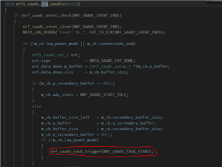

  • Hello again.
    Your case strongly resemblance the one described in this thread. In short, we have seen some issues where the layout of samples in memory are re-ordered when using the SAADC. This is usually a result of the START task being preempted/delayed after the SAMPLE task has been triggered by the PPI. A symptom of this issue is usually a reordering of samples in memory and loss of data from some channels ( it doesn't seem like you're observing the latter). The problem and purposed solutions are explained in the thread.
    However,  I would like you to try a couple of things before you try the solutions in that thread:
    1. I see that you only use one buffer, and call
      nrf_drv_saadc_buffer_convert() in the callback handler. This might be problematic if the SAMPLE task is triggered during the updating of the pointer to the result buffer. Try removing the function call from the callback handler. It shouldn't be necessary to call the function if you only use one buffer.
    2. You can try to increase the SAMPLES_IN_BUFFER
    Note: that you need to remove the trigger of TASK_START in nrfx_saadc_irq_handler() if you implement solution 1 in the linked thread.
    best regards
    Jared

    Thank you for the code.
    To elaborate on my thoughts behind my previous reply:
    As I've mentioned earlier, I wasn't 100% sure that your issue was indeed due to the START task being preempted. The ordering of the data in your buffer wasn't what I would have expected if the preempting was the case. It seems the data is ordered randomly, which is not quite what I've seen before with the other cases. Nevertheless, I figured that you should try to implement the workaround to see if it indeed solves your issue.
    Jared said:
    • I see that you only use one buffer, and call
    • You can try to increase the SAMPLES_IN_BUFFER
     After a further evaluation behind these suggestions I've changed my mind. It would be better if you just tried to implement the PPI with the START and END events. But, a prerequisite of using that suggestion is that you're using double buffering, which you are not using. Is there a specific reason for why you're not using it?
    Could you implement a double buffer and a PPI channel that links the START and END event together? You've implemented the PPI channel correctly, the only remaining part is to actually activate the channel by a call to nrf_drv_ppi_channel_enable(). Also, remember to comment out/remove the call to the START task in the IRQ handler when you implement this:
