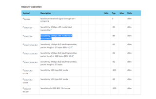

For the radio transmitter, why is it that BLE mode is slighty better than nRF mode when both at 2Mbps? Is there any trick to improve nRF mode?
Hi Devzone:
From this page describing 2.4Ghz Radio in infocenter:
2 Mbps nRF mode ideal transmitter has a sensibility of -89 dBm
2 Mbps BLE ideal transmitter, packet length ≤ 37 bytes, has a sensibility of -92 dBm, which is slightly better than nRF mode
I intend to use nRF mode.
Questions:
1. What's the reason that BLE is slightly better than nRF mode? Does it have to do with packet length?
2. Is there any trick to improve nRF mode?
