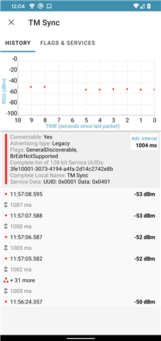

I am trying to add service data to my scan response service data for a custom service. I am unsure of how to set the UUID correctly for this.

This runs correctly, but the service UUID in the service data is the exact same as "TIMECODE_SERVICE_UUID" (0x0001). How do I combine this with the base UUID to set it to the actual service UUID (3fe10001-3073-4194-a4fa-2d14c2742e8b)? I've tried searching the documentation as well as these help forms and haven't found anything that is different from what I'm currently doing.

    Sorry, I don't think I phrased my question correctly. I'm aware that the base ID is the base for all bytes except 13 and 14 bytes, which are replaced by the two bytes for each specific service or characteristic (in my case TIMECODE_SERVICE_UUID, though I now realize from your example that I should be setting it to 0x0001 for consistency). What I don't understand is how to pass that value to service_data.service_uuid.
    For example, with the code above, service_data.service_uuid = TIMECODE_SERVICE_UUID will return 00000001-0000-1000-8000-00805f9b34fb (according to the Bluetooth library on my phone app I am working on), the Bluetooth base ID with my TIMECODE_SERVICE_UUID (0x0001). I need it to be my custom service ID (3fe10001-3073-4194-a4fa-2d14c2742e8b, which is TIMECODE_SERVICE_UUID using TIMECODE_SERVICE_UUID_BASE as the base).
    Is this possible? Or am I misunderstanding how service data sends the ID (eg. it it always 2 bytes, as the expected value for p_service_data_array.service_uuid is uint16_t)? Or maybe the ID I posted above is how the app library I am using on my phone interprets the service ID in the service data?

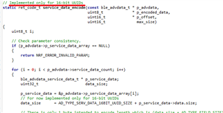

    Unfortunately, in the BLE advertising module in the SDK, we have only implemented support for 16-bit UUIDs when it comes to Service Data. Sorry for this inconvenience.
    Ah thank you, that answers my question. I guess I should either use the manufacture data or just use the service data with a generic ID.
