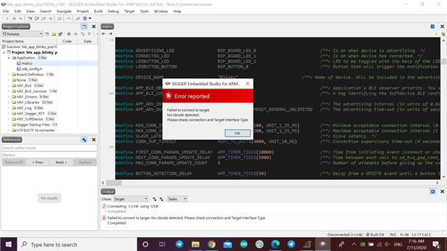

Hello, I'm working on a custom board, and I use JLink OB as programmer. Whenever I try to connect to nRF52811 on the board, this happens:
I check the connections, everything looks fine, Could It be because of the firmware of my Jlink OB?
    Looking at the screenshot attached, you seem to be using a project that is configured to be used for the nRF52840.
    Please try the pca10056e project instead. For the ble_app_blinky project, see the project in the folder SDK_folder\examples\ble_peripheral\ble_app_blinky\pca10056e\s112\ses
    You might find the Developing for nRF52811 user guide useful. See this link: infocenter.nordicsemi.com/.../nrf52811_user_guide.html

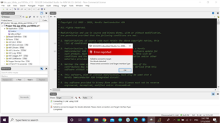

  • bardia3000 said:
    Unfortunately it is the same as before.

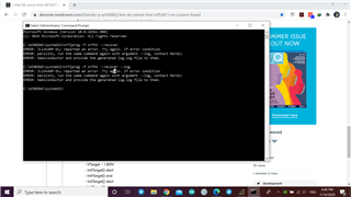

     Are you able to recover the device using nrfjprog ?
    nrfjprog --recover
    What voltage are you powering the nRF52811 with?
  • No I can't recover the device.
    nRF52811 is powering with 1v8, by the way I checked the programmer, It can program a nrf52832 (powered with 1v8) on another board correctly!

  • I also run "it as administrator" with J-link OB:
    and this is the log file:
