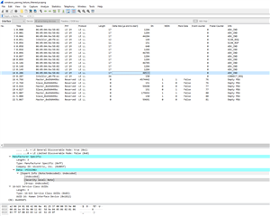

  • Any idea why it says Data: missing?
    It looks like the windows computer doesn't understand that this is in fact a keyboard, and that it doesn't do the service discovery. Perhaps you can test the ble_app_hids_keyboard example, and look at how it sets up the advertising data? I suggest you try including the uuid in the advertisement, so that the computer understands what sort of device it is.

  • I've modified the advertising data. It doesn't send the Manufacturer specific data and it uses the Appearance AD packet set to Generic HID device. I've looked up this structure from a Logitech BLE HID device.
    I've noticed that the BLE device doesn't receive the DM_CONN_UPDATE_IND. It says that the pairing completed successfully but that's it. When connecting to iOS it gets DM_CONN_UPDATE_IND and things continue properly. Windows doesn't use the RPA address while iOS does. That's the only difference that comes to mind right now.
  • I suggest you check by using the advertisement from the ble_app_hids_keyboard example, and see if the windows PC connects properly to that. If yes, then there is something missing that the windows is looking for. If not, then there may be something weird with the computer itself. Start taking away things from the advertisement packet until you are left with what you are currently using. What do you remove that makes the computer not do the service discovery?
