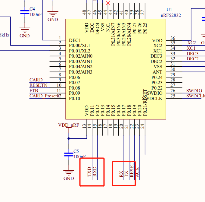

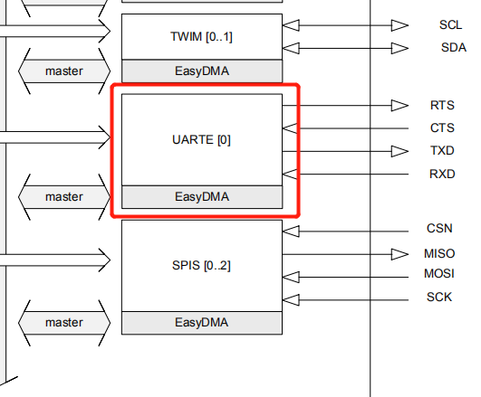

Thank you very much for your reply!I read the product specification ,but i don't know much about the peripheral UARTE.The nRF52832 has one physical UART just like the picture below
In my design,the nRF52832 is used as a MCU, the peripheral circuit contains two UART passthrough like the picture below
When i made this design, It just used one UART when the system worked. But now, i want to use two UART at the same time, so i have to build another UART by simulation. Can you provide me with relevant examples or documents?
Have a look at chapter 35 for UARTE and chapter 50 of the product specification for UART.
