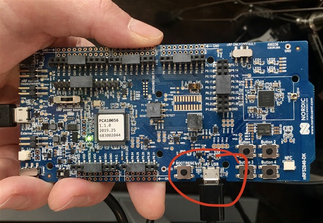

    I think I'm assuming that I need to update the default firmware, but maybe you can help confirm/deny that assumption: I'm trying to use the nRF USB port on the nrf52840 DK, not the "normal" debug/J-Link USB port. Is that possible with the default firmware?
    I've circled the "nRF USB" port in red below:
    nrf52840 DK
    You might try with connectivity_4.1.1_usb_with_s132_5.1.0.hex, although I do suspect it is built for the nRF52840 Dongle, not the DK, and therefore there may be some compatibility issue there. Might be worth a try, though.
    Terje
  • I was able to load the Dongle firmware (I used the s140 v6 hex instead), but the port didn't enumerate as a Bluetooth endpoint unfortunately. I think I'll need to wait to hear back on how to build the firmware from source.
