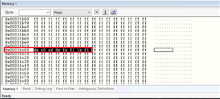

But after that i follow same step 21st time at this time I am getting problem in to step no 1 only but step 2 work properly.
so after 21st time I read flash in this my data is lost which is written in step no 1 only.
My question is what is the problem and how can I resolve this issue?
Also i observe that when i am getting below problem in this case i am showing some fix data is present into last page which is not written by me for reference I add below image,
So my question is what is indicate flash data mention in image?
Please give me some solution of it as soon as possible.
