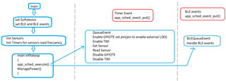

I am having an issue with my application which is really hard to replicate it could happens after 12 hours, 8 days, 1 month, 30s...
My software Diagram:
After some time when the unknown issues happens, the queue get filled then my module resets because the scheduler is out of memory to queue more events
The symtom looks like app_sched_execute() is not being called in the main loop, it makes me believe my code gets stuck on a loop somewhere.
I was digging on my code looking for loops, then I have only 2 loops
1) I made a low Power Delay where I use a loop and sd_app_evt_wait()

I used J-Scope to verified my code exits from this delay loop after I used RTT as well, then the issue is not here.
2) When perform TWI Write and Reads I have another loop where I wait for the transfer ends
void Twi::WaitForTransfer()
	while (Twi::GetInstance()->transferComplete)
	if(NRF_LOG_PROCESS() == false){
			APP_ERROR_CHECK(sd_app_evt_wait());
now I am aiming the root of my issue could be the TWI loop, but I cant no replicate it, because randomly happens, for example after my device working after 26 hours it is ok at the moment
3) when the issue happens and the queue gets totally filled it  generate an error out of memory, app_error_fault_handler is called then calling  NVIC_SystemReset() after this software reset, the module restarts then the queue gets filled since the beginning generating another software reset and keep resetting because the queue get filled again, and again (please look my RTT log below in the replies)
software reset wont solves it
hardware reset solves it temporally until this unknown behavior happens again, and again
When the issue happens, the neither BLE or TWI sensor works because both depend on the scheduler for my application
Possible causes:
a) TWI hangs and wont fire a handler event with TX or RX (TWI IRQs disabled because the frequency initialization/uninitialization?)
b) External Module unresponsive (?)
Details:
Queue Size 80
SCHED_MAX_EVENT_DATA_SIZE = BLE_STACK_EVT_MSG_BUF_SIZE + 247 (MTU)
SDK 13, nRF52832
Meli

    what can cause that the scheduler event/queue event wont fire anymore?
  • Below log using RTT where I call app_sched_event_put() every 1 second
    The output starts with ModuleStarts, when I initialize my module,
    QueueSize the Queue size just after calling app_sched_event_put
    QueueEvent when the queue is proceeded
    Then when I start receive errors at app_sched_event_put
    The messages are
    app_sched_queue_utilization_get(), Error code from app_sched_event_put(), and timelife in seconds from my app
     it shows the queue utilization after some time starts to increase and return error until my device restarts, how can I solve it?
