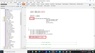

  • we developed a  2D-3D mouse .It contains a 2D sensor and a 3D sensor  and 4 touchpads for left click,right click and 3D motion enabling.
  • The SDK we are using for developing our application is   "nRF5_SDK_16.0.0_98a08e2"  and examples "ble_app_hids_mouse" .
  • We are using timer interrupt(app_timer) for reading and updating 2D ,3D sensor data and also to updating battery level  to host pc and the gpio interrupt is using for updating the  mouse clicks to host pc.
  • In our code we are enabling  all these interrupt after the bluetooth connection was established between our mouse and host pc .ie On "BLE_GAP_EVT_CONNECTED"  event  in main.c file  under "ble_evt_handler" function .Please look the below screen shot for better under standings.
  • Then we try to connect to our device  to host pc the connection was not establishing  in pc and its shows  "Try connecting your device again " .please look the below screen shot.
  • We find out the reason for this issue after some research and also with the support of nordic . ie,There are several other BLE events that are waiting to happen right after establishing a connection (BLE_GAP_EVT_CONNECTED event), as Service discovery, MTU update, data length update, PHY update, etc. if we are running so many things directly from inside the handling of the BLE_GAP_EVT_CONNECTED event we risk delaying and blocking other pending BLE softdevice events, and as a consequence perhaps even drop the connection if things take too much time.
  • So our solution to counter this issue was instead of enabling all the interrupt inside the BLE_GAP_EVT_CONNECTED event we just enabled a single shot timer with delay 1 sec here  and inside this timer handler we enabled all these interrupt.

    Edvin said:
    I guess you already know all the tricks, but does the log say anything? It may be an APP_ERROR_CHECK(err_code) or a hardfault.
     Edvin you are absolutely right .The issue is due  "APP_ERROR_CHECK(err_code)" .
    If we call "ble_hids_inp_rep_send" while BLE events taking place this function will return error. we removed the APP_ERROR_CHECK(err_code) from there, now every thing is working fine without  any timer delay.
    Thanks a lot for your support.
