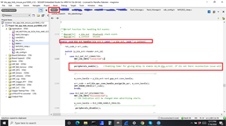

  • In our code we are enabling  all these interrupt after the bluetooth connection was established between our mouse and host pc .ie On "BLE_GAP_EVT_CONNECTED"  event  in main.c file  under "ble_evt_handler" function .Please look the below screen shot for better under standings.

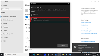

  • Then we try to connect to our device  to host pc the connection was not establishing  in pc and its shows  "Try connecting your device again " .please look the below screen shot.
  • We find out the reason for this issue after some research and also with the support of nordic . ie,There are several other BLE events that are waiting to happen right after establishing a connection (BLE_GAP_EVT_CONNECTED event), as Service discovery, MTU update, data length update, PHY update, etc. if we are running so many things directly from inside the handling of the BLE_GAP_EVT_CONNECTED event we risk delaying and blocking other pending BLE softdevice events, and as a consequence perhaps even drop the connection if things take too much time.
  • So our solution to counter this issue was instead of enabling all the interrupt inside the BLE_GAP_EVT_CONNECTED event we just enabled a single shot timer with delay 1 sec here  and inside this timer handler we enabled all these interrupt.
  • After this change in code we continuously  tested  our device on several PC .The result was uneven in different PC.ie, In some PC connectivity issue is showing and in some PC Its not showing .

  • when we increased the single shot timer interval to 5 sec connection issue was not showing in any PC but we can't allow this much delay to enable the all features in our device after the BLE connection was established.

    I have checked the sniffer trace. I can't see any obvious reasons for why the PC disconnects. Since the PC sends the LL_TERMINATE_IND packet, the connection is not timing out. It should have said that there was a timeout reason if there was something that wasn't replied to, but since it says "Remote User Terminated Connection", that suggests that there is no timeout. However, I checked the usual suspects (5 seconds and 30 seconds before the timeout), and there is nothing that isn't replied to, as far as I can tell.
    You say that the issue goes away if you delay the peripheral initialization with 5 seconds instead of 1 second, is that correct?
    If you are using an app_timer to trigger this, what IRQ is your app_timer running? What is APP_TIMER_CONFIG_IRQ_PRIORITY in your sdk_config.h?

    What IRQ are your peripherals running? Is it possible that any of these can delay the softdevice? In S132 interrupt priorities 5, 6 and 7 should be fine to use. 4 is reserved for the softdevice, while 2 and 3 can be used for time critical peripherals, but you should not spend too much time in these interrupts. anything below 1 is off limits.
    So does any of the peripherals you initialize use the priority below 5?

     Inside the "ble_evt_handler" . Now peripherals_enable() is used to start the timer . Please refer the below code  for better clarification.

  • Well, I assumed that the trace named PC_WITH_CONNECTION_ISSUE contained the issue. Apparently it did not.
    So from the last sniffer trace, that actually shows the issue, you can see that the peripheral (nRF) stops responsing. There is your issue.
    I guess you already know all the tricks, but does the log say anything? It may be an APP_ERROR_CHECK(err_code) or a hardfault.
    Are you able to reproduce this while debugging? does the log say anything? Does the execution stop, or is the application still running?
    Possibly right after you receive the encryption event.
