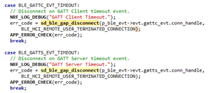

I am using nRF52840 to prototype and I want on certain occations to disconnect the peripheral from the central. On of these occations is when I charge my device. I tried the following snippet on the main for(;;) loop but it doesn't work
  for (;;) {
    int charging = nrf_gpio_pin_read(WC_CHG);
    // na - enter if statement when charging
    if (!charging) {
      if (charge_flag == true) {
        UN_state = BLE_STATE_CHARGING;
        ret_code_t err_code;
        bool check;
        check = nrf_sdh_is_enabled();
        if ((check == true) && (m_conn_handle != BLE_CONN_HANDLE_INVALID)) {
          err_code = sd_ble_gap_disconnect(m_conn_handle,
              BLE_HCI_LOCAL_HOST_TERMINATED_CONNECTION);
          if (err_code == NRF_SUCCESS) {
           NRF_LOG_INFO("Disconnected from Central");
        charging_state(UN_state);
      charge_flag = false;
    // Enter system On sleep mode
    idle_state_handle();
Any advice?
Thanks in advance
