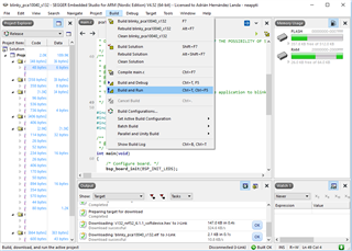

I can build the blinky_pca10040_s132 example and I loaded it in the nrf52840-DK without errors but nothing happens in the bord I can´t see any lead blinky.
Please can you let me know what I need to do ?
I defined:
Memory Segments as FLASH RX 0x0 0x80000;RAM RWX 0x20000000 0x10000
Target Device as nRF52840_xxAA
    Please use the example under pca10056 for nRF52840DK:
    nRF5_SDK_17.0.0\examples\peripheral\blinky\pca10056
    nRF5_SDK_17.0.0\examples\ble_peripheral\ble_app_blinky\pca10056
    The pca10040 is for nRF52832DK.
