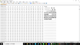

Hello everyone:
The problem is still not resolved
Test broad is PCA10056
Test code was modified by \SDK17.0\examples\peripheral\usbd_msc\pca10056\blank\ses
Try to create a directory and write a file on this
Open txt file like under picture,data damage on address 0x3200~0x3400 ,What am I doing wrong?

  • Hi Blance,
    Could you provide the code you used for automatic testing ?
    I tried to test here with your previous code again but the result is different now that I don't see the issue any more.
    But as you mentioned the issue rate is low at ~1/60. But it's strange that last time on the first trial I got the issue showed in the screenshot.
    Have you tried "nrfjprog --qspierase" before testing ? It's to make sure the qspi is fully erased before we test.
