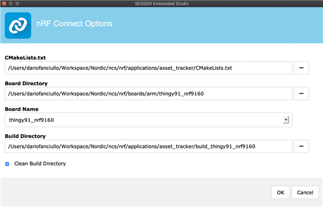

After setting up the toolchain, I tried to load an example code on SES, here are the options I used:

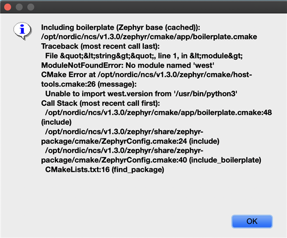

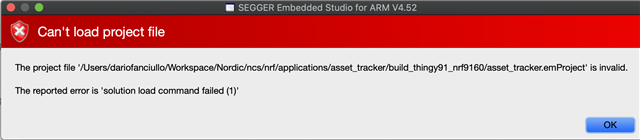

But I always receive this error:

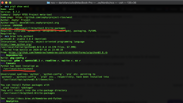

The path to west seems to be correctly set:
Any clue?

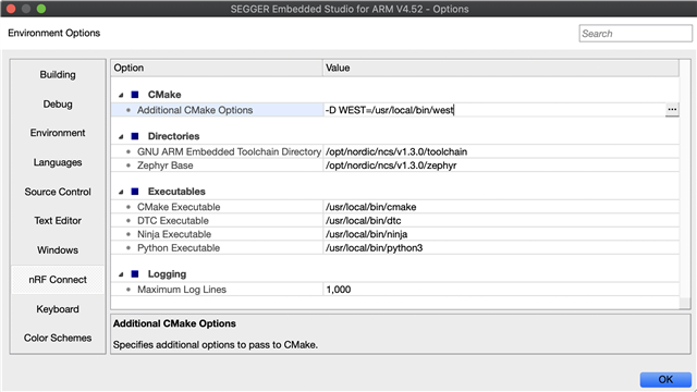

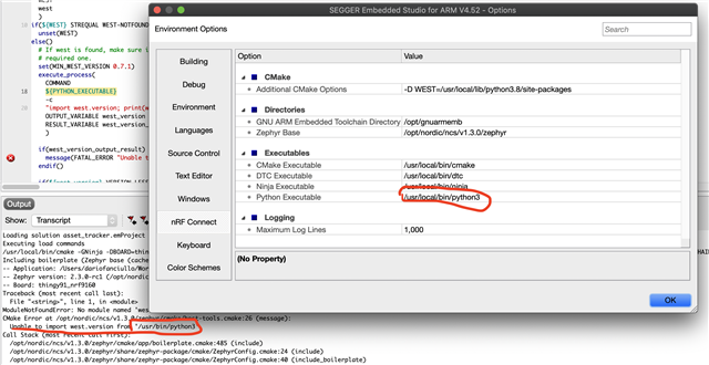

Thanks for the advice, now it works and it can load the west module.
Anyway, there is another error when it tries to import yaml.
It is correctly installed and if I try to import yaml myself it succeeds.
