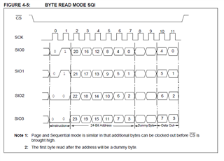

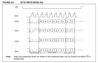

The RAM is a Microchip 23LC1024, wired up like a standard QSPI flash, I just need to use these commands when writting/reading:

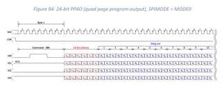

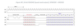

  • Alright Haakonsh, I think I ran into a game stopper. The RAM wants the commands sent on all four data lines not just one, which I don't see how to make happen. Any ideas?
    RAM:
    NRF:
    RAM:
    NRF:
