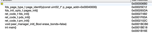

Hard fault on peer_manager_init after adding pm and flash storage to project
I started with the Blinky example and have added peer_manager to the project by referencing the hrs example. Everything is building, but on init() I am getting a hard fault with the following stack trace:
The exact line is in page_identity
    if (p_page_addr[FDS_PAGE_TAG_WORD_0] != FDS_PAGE_TAG_MAGIC)
The value of p_page_addr is 0x00040000
I double checked my flash_placement file and it is the same as the hrs file:

I also double checked my sdk_config and it is the same as the hrs example:
// <e> FDS_ENABLED - fds - Flash data storage module
#ifndef FDS_ENABLED
#define FDS_ENABLED 1
#if  FDS_ENABLED
// <o> FDS_OP_QUEUE_SIZE - Size of the internal queue.
#ifndef FDS_OP_QUEUE_SIZE
#define FDS_OP_QUEUE_SIZE 4
// <o> FDS_CHUNK_QUEUE_SIZE - Determines how many @ref fds_record_chunk_t structures can be buffered at any time.
#ifndef FDS_CHUNK_QUEUE_SIZE
#define FDS_CHUNK_QUEUE_SIZE 8
// <o> FDS_MAX_USERS - Maximum number of callbacks that can be registered.
#ifndef FDS_MAX_USERS
#define FDS_MAX_USERS 8
// <o> FDS_VIRTUAL_PAGES - Number of virtual flash pages to use.
// <i> One of the virtual pages is reserved by the system for garbage collection.
// <i> Therefore, the minimum is two virtual pages: one page to store data and
// <i> one page to be used by the system for garbage collection. The total amount
// <i> of flash memory that is used by FDS amounts to @ref FDS_VIRTUAL_PAGES
// <i> @ref FDS_VIRTUAL_PAGE_SIZE * 4 bytes.
#ifndef FDS_VIRTUAL_PAGES
#define FDS_VIRTUAL_PAGES 3
Any help would be appreciated
