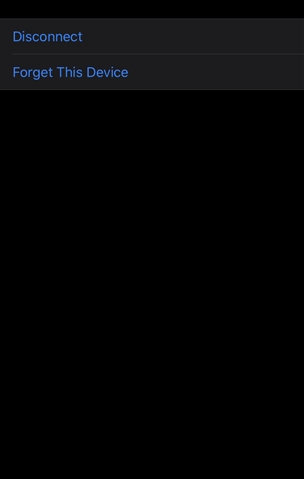

1) Is it posible to disconnect from the central side (ios)? I would like to be able to disconnect as follows:

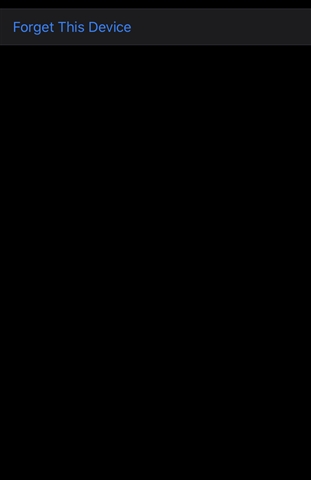

But when I run the HID keyboard example I'm only able to Forget the Device as shown below. Is there a way to do this?
