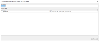

    The values from sensor a stores in uint8_t puffer "m_sample". I would like to see the actual values of this array of bytes.
    For this, I press "build and debug" (debug is the active buld configuration). After that, I make a right click to m_sample --> quick watch. Unfortunaly, there is not the actual value shown.
    Do I have to activate something in for debugging? Is there somewhere explained, how to see actual values stored in variables in general?
    Thanks in advance
    Simon
  •  You need to halt the cpu in order for the watched states to update. Use a breakpoint or manually halt the CPU with the halt button/command
    If the Watch window does not work, then you need to find the address in Memory where the buffer is stored and go to the Memory view. You still need to halt the cpu.
