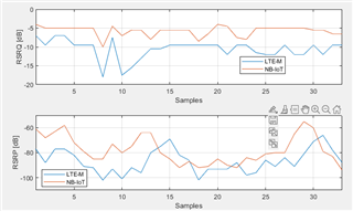

I programmed two thingy:91 to return RSRP and RSRQ to a server. On is running with LTE-M and the other with NB-IoT.
I found something that seems strange : +CESQ: 99,99,255,255,20,38
How can the signal power be below -100dBm and the signal quality be around -9.5dB ?
If you have any clue or link to understand that it would be great.
