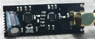

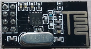

I have one PTX and one PRX, both nRF24L01+ with PA and LNA. PTX send 4 bytes to PRX but PRX doesn't get RX_DR, and PTX fire MAX_RT.

I see PTX doesn't send the data, therefore PRX doesn't get RX_DR=1 and neither PIN_IRQ=0.
PTX never get ACK from PRX.
Any idea, please?
