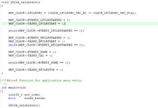

    LFRC is used, and the configuration is as follows:
    And the internal clock calibration is added at the beginning of the program, this problem still occurs.
  • The clock is automatically calibrated by the softdevice. Are you calling that function in intervals, or is it just at the beginning of main? In any case, it is not really necessary. Anyways, if it always works fine within 3 meters I think we can rule out any clock drifting problems.You can of course try to set the clock accuracy to 500ppm and see if the problem improves.
