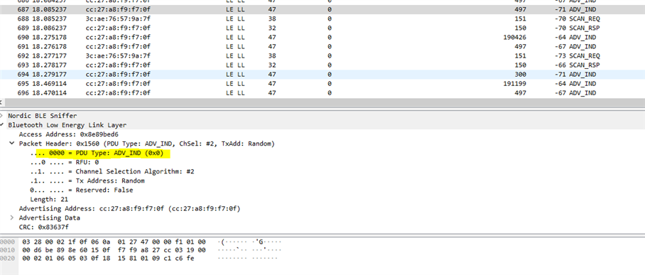

  • I have attached a sniffer log from one of the devices not is not connection to IOS. Same behavior as described previously: device is discoverable, it is connectable with android app and nrf connect, it is not connectable with IOS app or IOS nrfConnect. This device also had a device name corruption issue where the device name is empty. We have seen this correlates with the IOS connectivity issue, but we have also had devices with non-empty device names not connect.

  • Hi Rberanek,
    From the sniffer trace I don't see any problem with the advertising packet. It's advertise as connectable packet.

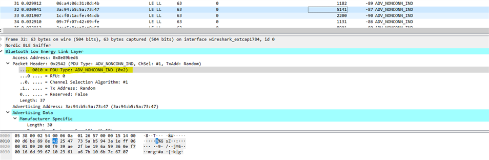

    I give an example here of a non connectable packet:
    You can find the PDU type of 0x02 when in your sniffer trace it's 0x00 meaning it's a normal connectable advertising packet:
    Have you tried to use another phone to check if it shows the device as connectable or not ? Please try to restart the phone as well.
