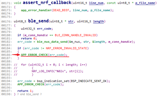

When disconnect, some ble_peripheral is error "Unknown error code", source code as below.
uint8_t ble_send(uint8_t * str, uint16_t length)
    uint32_t err_code;
		return 0;
	err_code = ble_nus_data_send(&m_nus, str, &length, m_conn_handle);
//	for (uint32_t i = 0; i < length; i++)
//				NRF_LOG_INFO("%02x", str[i]);
	err_code = bsp_indication_set(BSP_INDICATE_SENT_OK);
	return 1;
I wonder if the release program needs to block error code detection?
